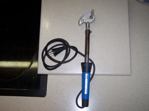

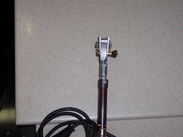

After watching John's video yesterday on bending binding or binding bending, I remembered something from my past. About 20 years ago I was into model ship building and I had a tool that was made for bending ship planks (same as binding). So I dug through all my stuff and found that tool. I haven't plugged it in yet, but it worked well years ago and seems to still be like new. Thought someone might have one, though I've not seen any mention of it here, or might like to find one and try it. You just wet the wood and place it in the bender, plug it up and bend. Can't wait to try it when I bind my peg head.
It will take binding up to 3/8" wide.
This one came from Model Expo in New Jersey, about 20 years ago.

Than looks Cool Ron

By the way, all, the bender in the picture was made in Torino, Italy. Thought that was kinda neat. Luigi might be able to find them for a song.
